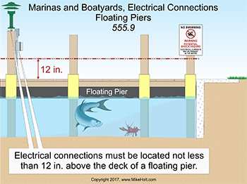

Electrical connections must be at least 12 in. above the deck of a floating pier. If the conductor splices are contained within approved junction boxes utilizing sealed wire connector systems listed and identified for submersion, they can be above the waterline but below the electrical datum plane for floating piers [555.9]. Figure 555 09 01
For a fixed pier, electrical connections must be at least 12 in. above the deck, and never below the electrical datum plane.
