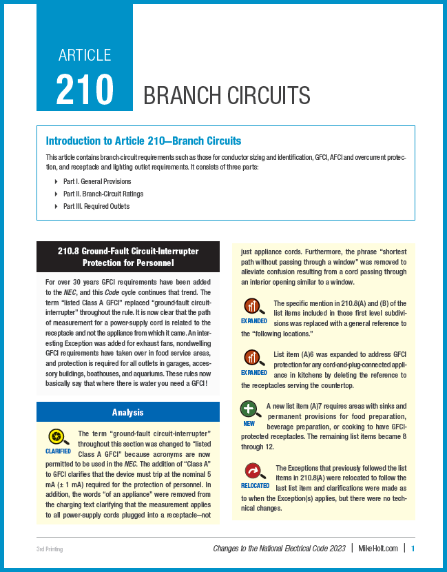

Ground-Fault Circuit-Interrupter Protection for Personnel [210.8]
This content is extracted from Mike Holt's 2023 Changes to the National Electrical Code Video Program.
Click here or on the thumbnail to view or download the PDF of this rule. (10 pages, 2,293 KB)
Do you think the inclusion of acronyms in the NEC improves usability?
The 2023 NEC introduces a notable change to include the use of acronyms for clarity and efficiency. For instance, a ground-fault circuit interrupter can now be referred to by its acronym, "GFCI". But did you know there are different types of GFCI devices? If you saw the term SPGFCI in the Code, would you know what type of device it refers to?
Dive deeper into how the acronym "GFCI" and its variations are used in the NEC by reading the attached text and watching the video.
