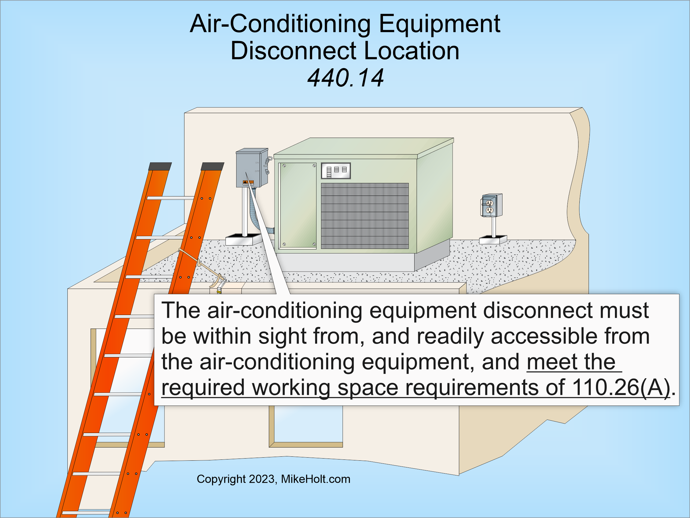

If the air-conditioning disconnecting means is readily accessible to unqualified persons, the disconnect enclosure or hinged door that exposes energized parts when opened must require a tool to open or be capable of being locked [440.11].
A disconnect for air-conditioning equipment must be within sight and readily accessible from the air-conditioning equipment. It must also meet the required working space requirements of 110.26(A) [440.14]. Figure 01
“Within Sight” means it is visible and not more than 50 ft from the location of the equipment [100]. “Readily Accessible” means capable of being reached quickly for operation, renewal, or inspection without requiring the use of tools (other than keys). It also means people don’t need to climb over or under obstructions, remove obstacles, resort to using portable ladders, etc. [100].
The disconnect can be mounted on or within the equipment, but it cannot be on panels designed to allow access to internal wiring or where it obscures the equipment nameplate [440.14].
