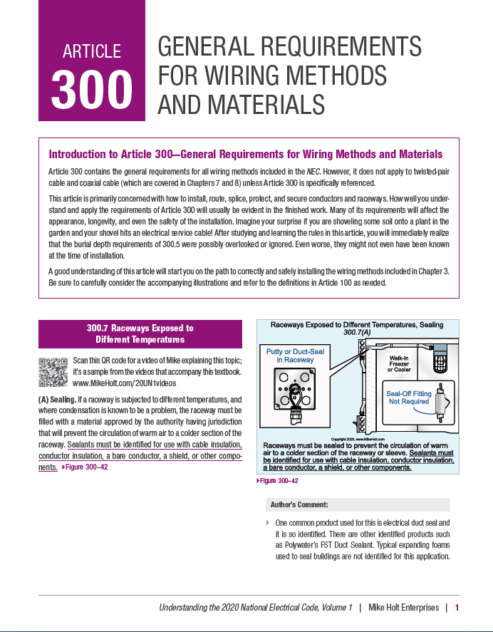

Do you know where raceways are required to be sealed in accordance with the National Electrical Code?
Condensation could accumulate in raceways that are subjected to temperature differences as a result of air circulating through the raceway from a warmer to a colder section. The circulation of air within the raceway can be prevented by sealing the raceway with a suitable compound before it enters the colder section.
Learn how the transference of moisture inside raceways can be prevented by reading the attached text and watching the video where Mike and the team discuss NEC 300.7
