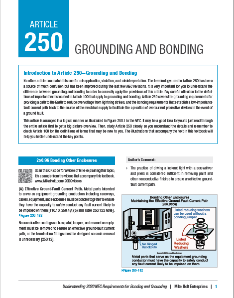

The content below is extracted from Mike Holt's Understanding NEC Requirements for Bonding and Grounding based on the 2020 NEC textbook.
Click here or on the thumbnail to the left to view or download the PDF of this rule. (1 page, 176 KB)
When it comes to making the use of electricity safer, nothing can compete with the bonding requirements of the NEC. Remember that bonding is the connection(s) made to ensure the continuity of all noncurrent-carrying metal components of an electrical system.
But what exactly is meant by other enclosures? Well other enclosures are, metal raceways, cable trays, cable armor, cable sheath, enclosures, frames, fittings, and other metal non“current-carrying parts that are to serve as equipment grounding conductors or part of an effective ground-fault current path. Any nonconductive paint on equipment must be removed to ensure electrical continuity and the capacity to conduct safely any fault current likely imposed. This rule has to do with the performance requirements of grounding and bonding, for example if a non-metallic raceway is installed with metallic boxes then 250.96(A) requires us to bond the metal box.
So why is bonding so important and how does it make using electricity safer? Read the attached PDF, study the graphic, and watch this informative video as myself and a panel of experts explain.
This content is extracted from Mike Holt's Understanding NEC Requirements for Bonding and Grounding, based on the 2020 NEC Program.
