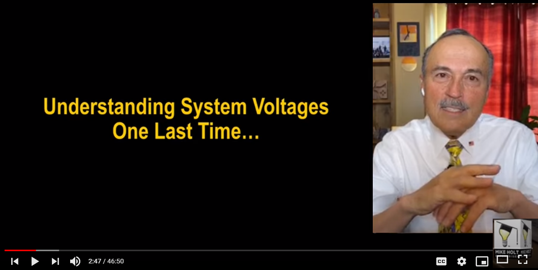

Understanding System Voltages
Click on the image above to watch the video [46min:28sec]
The system voltage that we're probably most familiar with is the typical 120/240V single-phase electrical service to a residential occupancy. But there are many occupancies that have different electrical requirements such as higher nominal voltages. What exactly are the other common system voltages and where do these higher voltages such as 277/480V come from? What about single-phase vs. three-phase voltage requirements and how come in three-phase the voltage is normally 120/208V? Just how is electricity transformed to meet specific electrical needs?
To really understand system voltages, watch this video where we'll explain not only the theory behind system voltages but also some of the safety grounding and bonding considerations and what consequences might happen if we don't follow NEC requirements surrounding separately derived systems.

  • In this video at 3:05 minutes the diagram has the primary voltage as 480V/20 turns = 48V per turn. This should be 24V per turn. The secondary shows 24V per turn X 5 = 240V. This should be 120V.
    Walter  March 23 2021, 11:43 am EDT
    Reply to this comment
  • Reply from: Mike Holt   March 23 2021, 5:32 pm EDT
    Sorry for the 'typo' in the graphic. Thanks for letting me know.
