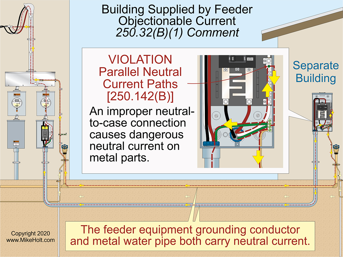

Figure 01
![](https://www.mikeholt.com/files/NLImages/250.32B1-02.jpg) |
Figure 01

Q1. What is the Code rule for connecting a grounding electrode system to a building supplied by a feeder?
A1. 250.32 Buildings Supplied by a Feeder
(A) Grounding Electrode. A building supplied by a feeder must have a grounding electrode system and a grounding electrode conductor installed in accordance with Part III of Article 250. [250.32].
Ex: A grounding electrode is not required for a building if it is supplied by a single branch circuit or multiwire branch circuit.
![](https://www.mikeholt.com/files/NLImages/caution-.png)
To prevent dangerous objectionable neutral current from flowing on metal parts [250.6(A)], the supply circuit neutral conductor is not permitted to be connected to the remote building disconnect enclosure [250.142(B)]. Figure 01
