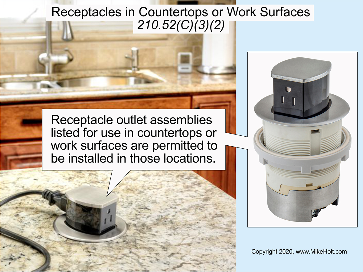

(2) In countertop or work surfaces: Receptacle outlet assemblies listed for use in countertop or work surfaces are permitted to be installed in countertops or work surfaces. Figure 01
Author’s Comment:
►Installing receptacles below the countertop was limited in the previous Code because of the increased possibility that a toddler could pull on an appliance cord and pull an appliance down on him or her thereby creating a burn or scalding hazard.
►A clearer distinction between a countertop and a work surface is not yet defined for an accurate and effective application of this rule. This is critical if “pop-up” type receptacles are used. There are several products listed for use in work surfaces, but as of this writing, only one is listed for use in a countertop.
