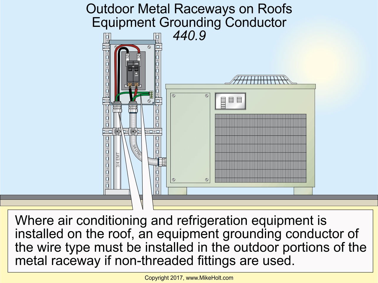

Q2. What does the NEC require for equipment grounding and bonding of air conditioning and refrigeration equipment installed using a metal raceway that is run exposed on a roof?
A2. Where equipment is installed using a metal raceway is run exposed on a roof for air conditioning and refrigeration equipment, an equipment grounding conductor of the wire type must be installed within the outdoor portions of metal raceways that use non threaded fittings [440.9].Figure 01
