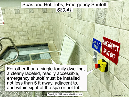

Emergency switch
In other than a one-family dwelling, you must supply a clearly labeled emergency shutoff for a spa or hot tub water recirculation and jet system. You can use either the maintenance disconnect [680.13] or a pushbutton that controls a relay.
The emergency shutoff must be readily accessible to users and at least 5 ft away, adjacent to, and within sight of the spa or hot tub [680.41], Figure 1. This requirement applies to spas and hot tubs whether installed indoors or outdoors.
