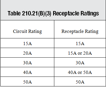

Q1. What are the NEC requirements for sizing receptacles?
A1. A single receptacle on an individual branch circuit must have an ampacity not less than the rating of the overcurrent device [210.21(B)(1)].
Note: A single receptacle has only one contact device on its yoke [Article 100]; this means a duplex receptacle is considered as two receptacles.
If a receptacle is connected to a branch circuit that supplies two or more receptacles, the total cord-and-plug-connected load must not exceed 80 percent of the receptacle rating [210.21(B)(2)].
Author’s Comment: A duplex receptacle has two contact devices on the same yoke [Article 100]. This means even one duplex receptacle on a circuit makes that circuit a multioutlet branch circuit.
According to 210.21(B)(3), if the receptacle is connected to a branch circuit that supplies two or more receptacles, the receptacles must have an ampere rating in accordance with the values listed in Table 210.21(B)(3).
